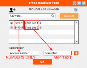

Adding Provider (The Person You're Copying From)
From here you click on PROVIDER LIST and add the numbers you received in the email. Add the number under ACCOUNT NUMBER and under DESCRIPTION you can add whatever you like – “Uncle Lee” for example.
If you receive an error like the one below contact an admin in the group. This means that your account is not enabled on both sources as yet – you should wait for a confirmation email or message from an admin. If you received this confirmation but still get the error below then definitely contact an admin.

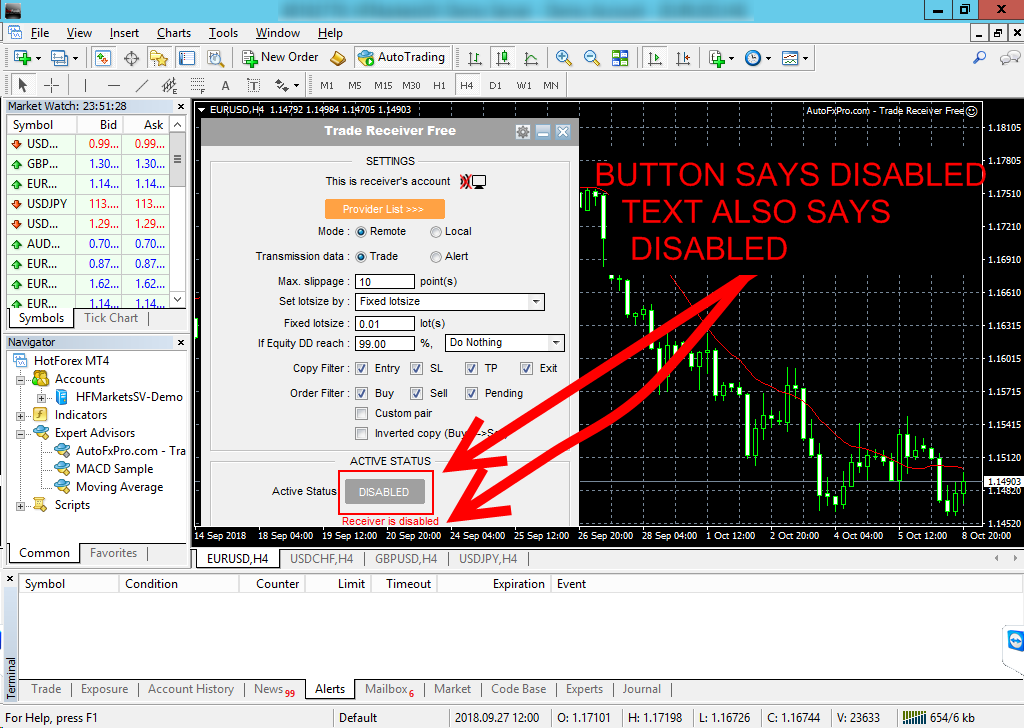

The final step is to enable the copier after adding the providers. This is done by clicking on the button that says DISABLED at the bottom of the copier.

Enabling The Copier
These last pictures show where to click to enable the copier AFTER adding the two provider numbers.

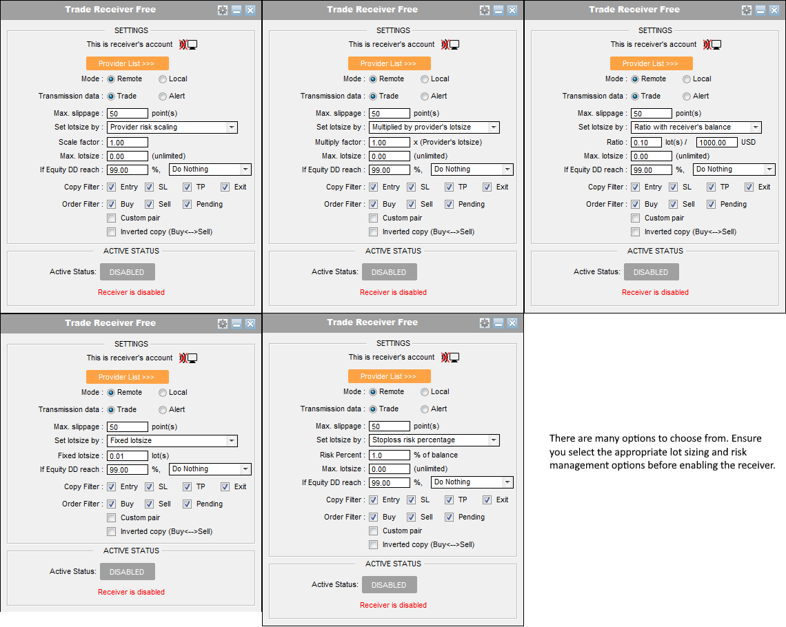

There are 15 main settings with various sub-settings.
1 - The Provider List
2 - Mode
This changes between remote and local. If you’ve purchased the provider software and are running it on the same PC/laptop/VPS then you can switch to LOCAL mode.
3 – Transmission Data
This will either trade the account or just give you pop-up alerts of trades taken by your provider.

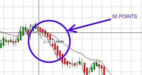

4 – Slippage
Slippage determines how far away from price a position will open/close. This is based on the lowest value available for the chart you are on. If your chart is in PIPS then it will be different from POINTS or PIPETTES (same as TICKS). The default should be OK but modify as you wish. The image below shows what it would look like on a chart. You may zoom in for more details.
RTENOTITLE
Again, this is not a comprehensive document, but intended to give a visual of what you should be looking for. If you need more details please consult the original manual. Some items are there that I may not fully understand the terminologies or what is meant by the person that originally wrote the program. Use or modification of the settings are done at your own risk – this is why each person has to change the settings to suit their needs.
5 – No Copy Later Than
This very useful feature ensures that no trades are taken if a certain amount of time (in seconds) has passed.
6 – Set Lot Size By
This section has 5 sub-sections.
6.1 – Provider Risk Scaling
This opens trades based on the provider’s account size and lot size of their position versus your account size. This means if your account is $500 and the provider is $1,000 your lots will be opened at half of what the provider uses. Bear in mind that there is no position smaller than 0.01 and as a result trades taken at this size will be copied directly.
6.2 – Multiplied By Provider’s Lot Size
You can manually multiply the lot size that the provider uses to match your preference.
6.3 – Ratio With Receiver’s  Balance
This will open the lots based on settings you place for the balance/equity you have available.
6.4 – Fixed Lot Size
This will open a fixed lot regardless of what lot size the provider uses.
6.5 – Stop Loss Risk Percentage
This will specify your risk for each trade if a stop-loss occurs.
7 – Risk Setting

11 – Order Filter
You can determine whether you want BUYS, SELLS or PENDINGS to be copied.
12 – Custom Pair
You can determine whether or not you only want certain pairs to be copied. The following information is taken directly from the manual - which should be available to you from your copy provider or the official website.
Custom pair: Only copy trade of custom pair (combine with order types above). You can input multiple pairs by putting comma (,) or semicolon (;) between them. E.g: EURUSD; GBPUSD; USDJPY. You can also exclude the pairs by putting exclamation (!) in front of the pairs. E.g: !EURUSD; !GBPUSD; !USDJPY.
13 – Inverted Copy
This can be useful for a poorly performing provider/EA being copied. You can invert the buys/sells and use this to gain pips while the provider is losing.

Auto Trading Is Disabled
If you are getting this message then you probably did not follow the instructions on page 11 of this document. Please review and then press F7 on your keyboard which will bring up the properties for the copier. Click on COMMON and then ALLOW LIVE TRADING. Please see photos of that below. Ensure it is checked.
The final product should look like the one below. Once done, click on OK and proceed with the setup.

Adding Receivers / Local Copies
The copier may be used in remote or local mode. In remote mode you must add the MT4 account number for each receiver. In local mode you only need the provider number to be placed in each client.
Remote Provider
If you're going to be sending signals over the internet, then ensure that you have the account numbers for the persons that will be copying. If your service is a paid service then check your subscription list and you can then enable/disable receivers as needed. Firstly, go to the RECEIVER LIST.
From this screen you can add the ACCOUNT NUMBER for each receiver along with a DESCRIPTION. Usually the subscriber name or email address is placed here to make them easier to be found. You may also set an EXPIRY which would automatically disable the account once the expiry date is reached.
Local Copy
This mode is faster than remote and the prompt that appears when you switch the modes tells you just that.
Just like the receiver - you simply press the DISABLED button to enable the provider. Note that in LOCAL mode there is no subscriber list. All you need to do is put in the provider number in all of the receivers for trades to be copied.
