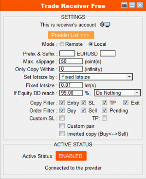

SETTINGS
There are 15 main settings with various sub-settings. A 16th setting will be covered at the end.
1 - The Provider List
2 - Mode
This changes between remote and local. If you’ve purchased the provider software and are running it on the same PC/laptop/VPS then you can switch to LOCAL mode.
3 – Transmission Data
This will either trade the account or just give you pop-up alerts of trades taken by your provider.
4 – Slippage
Slippage determines how far away from price a position will open/close. This is based on the lowest value available for the chart you are on. If your chart is in PIPS then it will be different from POINTS or PIPETTES. The default should be OK but modify as you wish. The image below shows what it would look like on a chart. You may zoom in for more details.
Again, this is not a comprehensive document, but intended to give a visual of what you should be looking for. If you need more details please consult the original manual. Some items are there that I may not fully understand the terminologies or what is meant by the person that originally wrote the program. Use or modification of the settings are done at your own risk – this is why each person has to change the settings to suit their needs.
5 – No Copy Later Than
This very useful feature ensures that no trades are taken if a certain amount of time (in seconds) has passed.
6 – Set Lot Size By
This section has 5 sub-sections.
6.1 – Provider Risk Scaling
This opens trades based on the provider’s account size and lot size of their position versus your account size. This means if your account is $500 and the provider is $1,000 your lots will be opened at half of what the provider uses. Bear in mind that there is no position smaller than 0.01 and as a result trades taken at this size will be copied directly.
6.2 – Multiplied By Provider’s Lot Size
You can manually multiply the lot size that the provider uses to match your preference.
6.3 – Ratio With Receiver’s Balance
This will open the lots based on settings you place for the balance/equity you have available.
6.4 – Fixed Lot Size
This will open a fixed lot regardless of what lot size the provider uses.
6.5 – Stop Loss Risk Percentage
This will specify your risk for each trade if a stop-loss occurs.
7 – Risk Setting
This option changes based on the options you select. Examples (from an older version) can be seen below. You may click each image for a larger view.
8 – Max Lot Size
You can determine the maximum lot size to be opened overall by the copier.
9 – If DD Equity Reach %
You can set the copier to do various things if your equity gets to a certain point. These options include stopping the copier.
10 – Copy Filter
You can decide with this option if you want to copy certain aspects of each trade or not.
11 – Order Filter
You can determine whether you want BUYS, SELLS or PENDINGS to be copied.
12 – Custom Pair
You can determine whether or not you only want certain pairs to be copied. The following information is taken directly from the manual - which should be available to you from your copy provider or the official website.
Custom pair: Only copy trade of custom pair (combine with order types above). You can input multiple pairs by putting comma (,) or semicolon (;) between them. E.g: EURUSD; GBPUSD; USDJPY. You can also exclude the pairs by putting exclaimation (!) in front of the pairs. E.g: !EURUSD; !GBPUSD; !USDJPY.
13 – Inverted Copy
This can be useful for a poorly performing provider/EA being copied. You can invert the buys/sells and use this to gain pips while the provider is losing.
14 – Enable / Disable Button
This enables or disables the copier.
15 – Copier Status
This shows the general state of the copier.

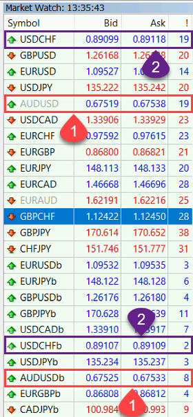

16 – Prefix & Suffix
Some pairs may have prefix/suffix as seen in the example below.
If this is the provider account then there's nothing to change. In later versions of the receiver however, there are options for prefix and suffix.
You'll notice the options near the top with an example of EURUSD given. In the market watch window example - if the receiver account has multiple pairs with varying prefix/suffix - and you've tested and confirmed which should be used based on your account - set the appropriate prefix/suffix for the one that should be copied to. Once done, the copier will copy to all pairs with the same prefix/suffix. The EURUSD given is an example for visual aid.

Local Copy
This mode is faster than remote and the prompt that appears when you switch the modes tells you just that.
Just like the receiver - you simply press the DISABLED button to enable the provider. Note that in LOCAL mode there is no subscriber list. All you need to do is put in the provider number in all of the receivers for trades to be copied.
