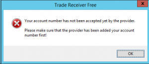

Account Not Accepted
If you have waited 24-48 hours and are still getting this message contact an admin.
