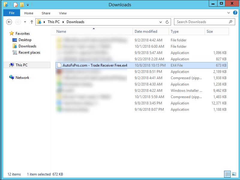

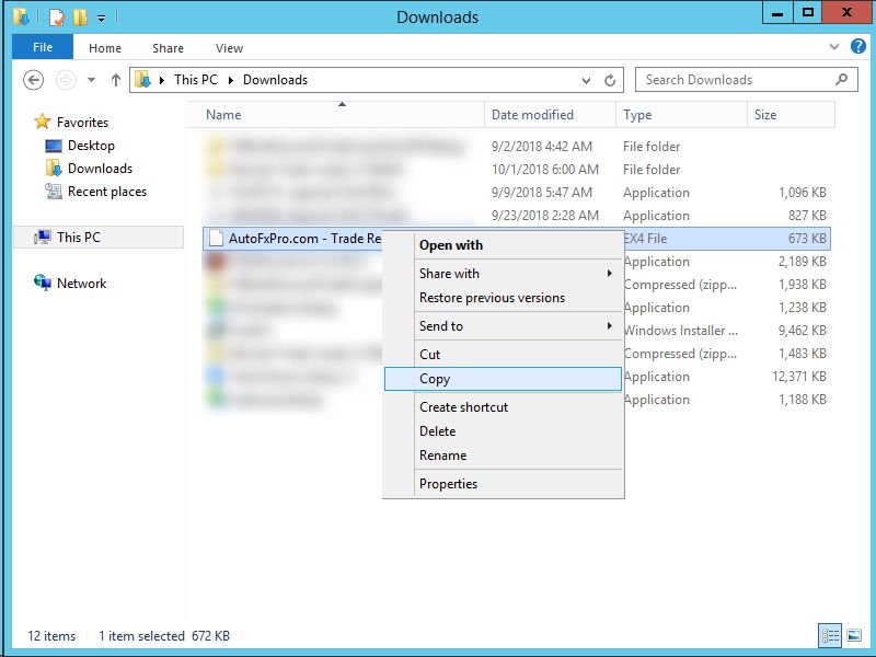

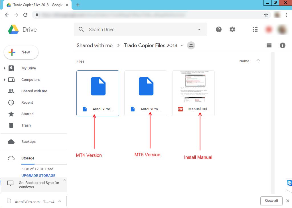

Your copy service provider may have given you a link to download the files - this can be from any source - Google Drive - DropBox - OneDrive - email - their own website - or a link to the original AutoFXPro site. Regardless, download the file that's appropriate for your installation.

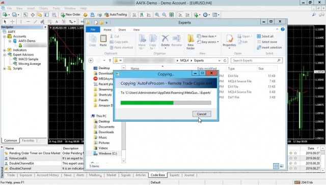

Once you have this file downloaded, you will need to COPY the file. Do so by right-clicking and selecting COPY from the list of options.

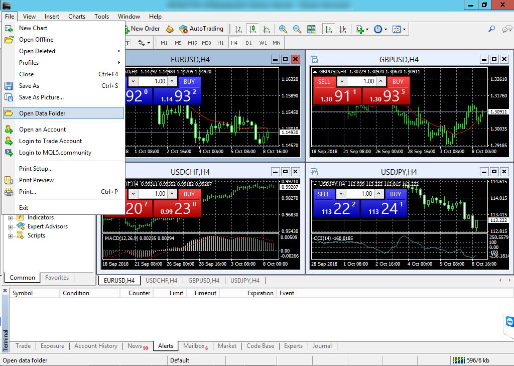

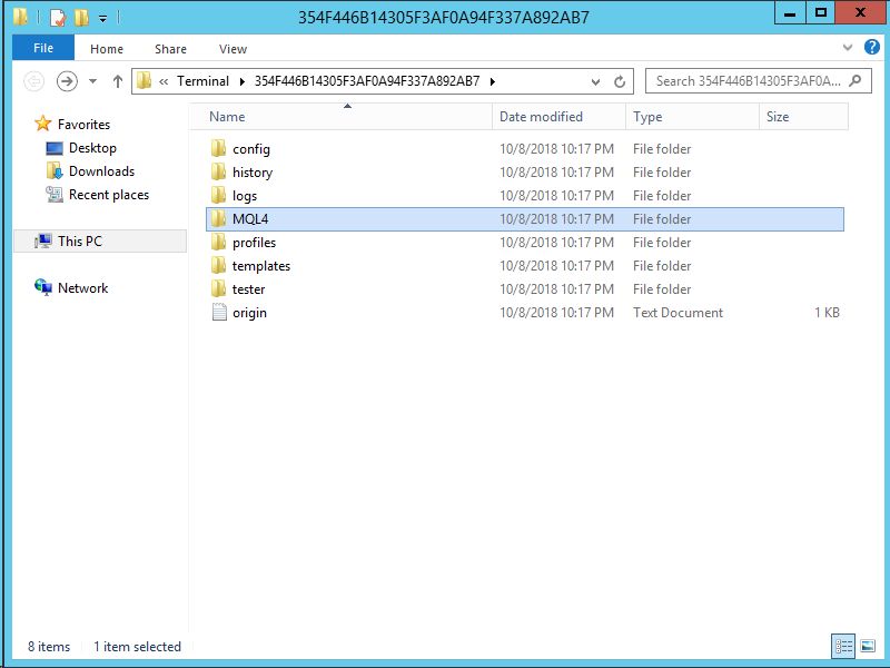

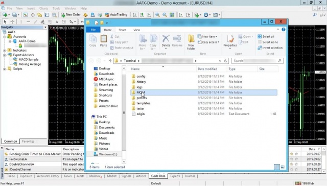

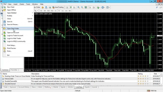

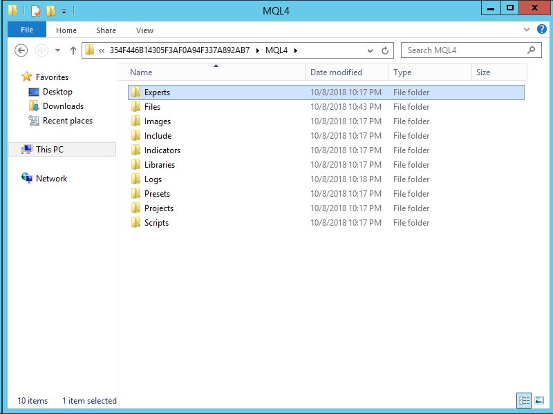

Once this is done, go back to your MT4/5 and open the data folder. To do this, go to FILE then OPEN DATA FOLDER.

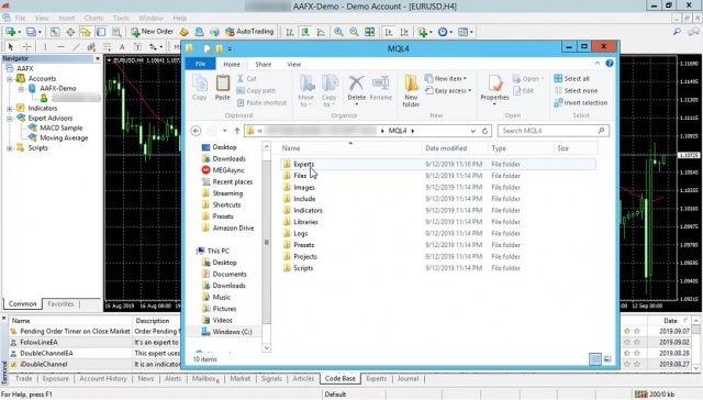

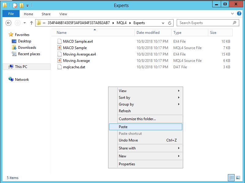

This will open an EXPLORER window to the data folder. You then need to navigate to MQL4\EXPERTS and paste the file. If you’re using MT5 the folder will be MQL5\EXPERTS

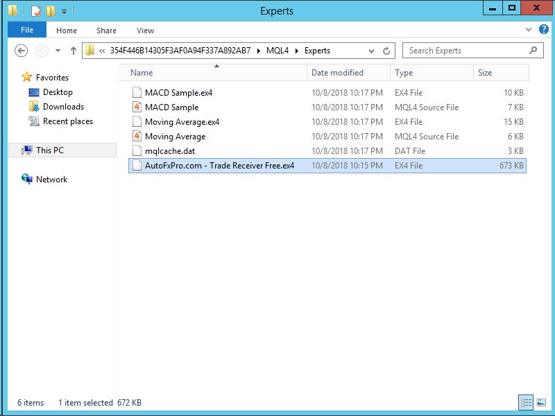

Once in the EXPERTS folder you will RIGHT-CLICK and PASTE.

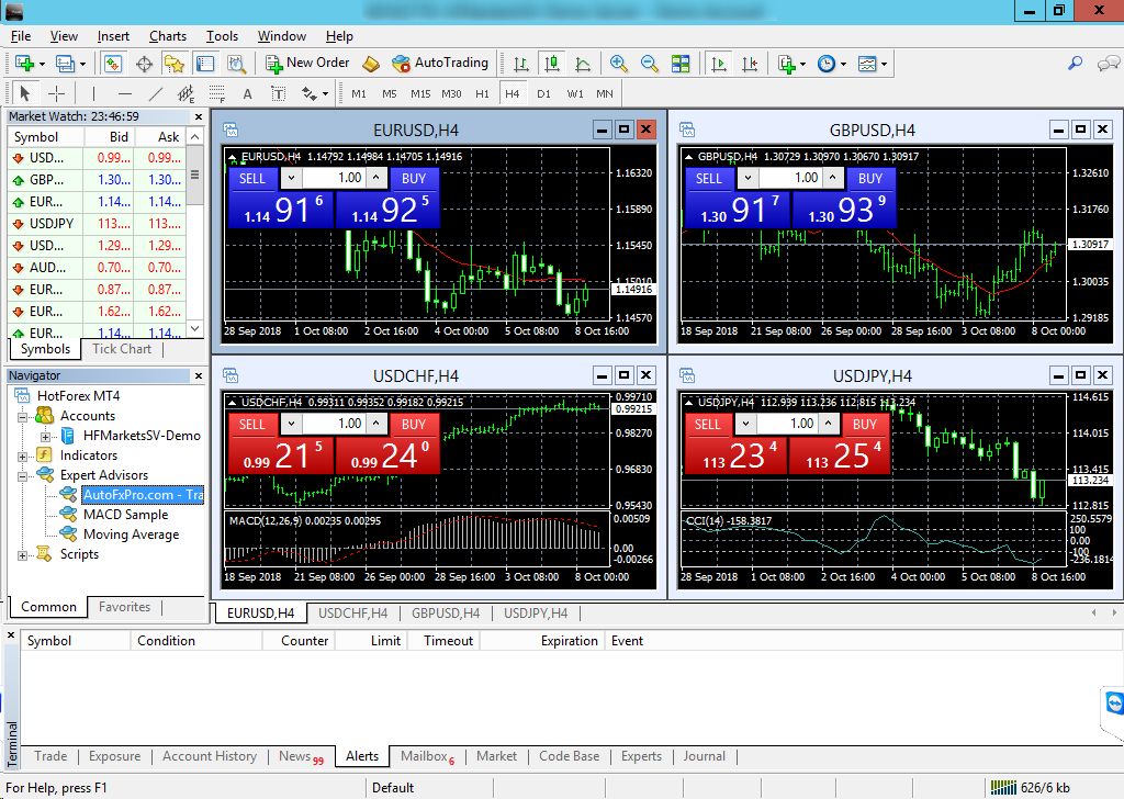

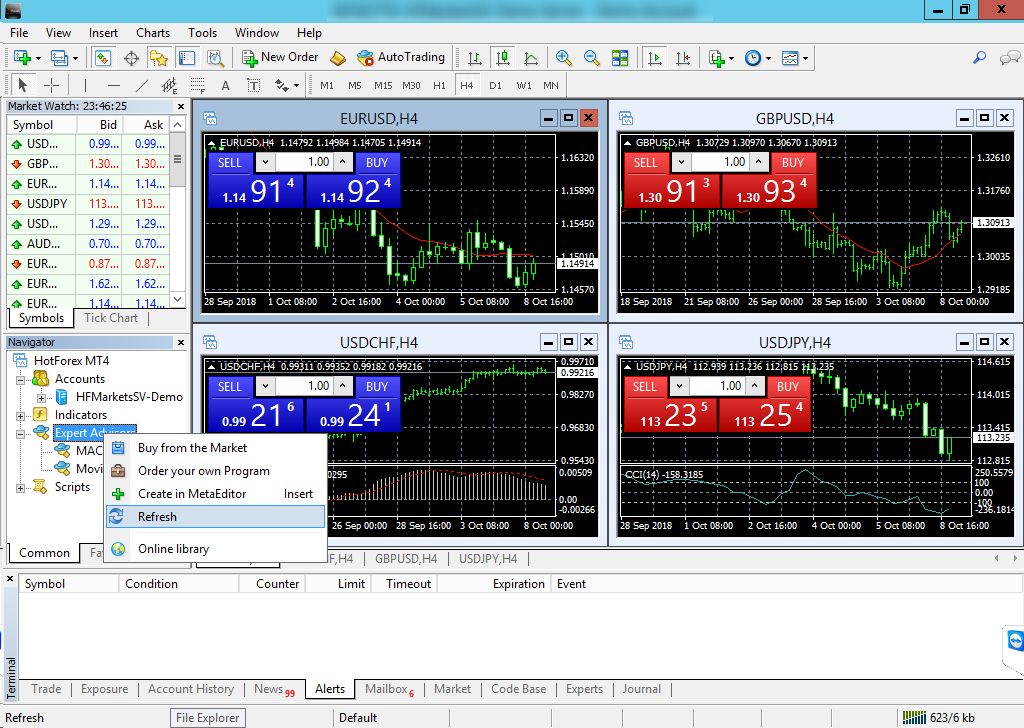

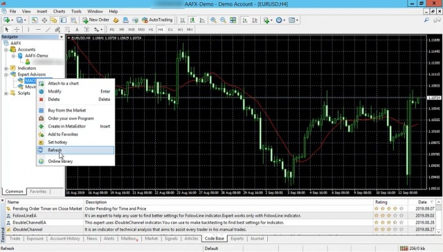

This will place the file you’ve downloaded into the EXPERTS folder. From here you go back to your MT4/5 which should be running. You may close all other open windows/programs except your MT4/5.
Click on the + beside EXPERT ADVISORS in the “Navigator” window to expand the view. Then RIGHT-CLICK on EXPERT ADVISORS and go to REFRESH.
Once you do this the copier will show up in the list. If it doesn't, simply close your MT4 and open it after waiting a few seconds.

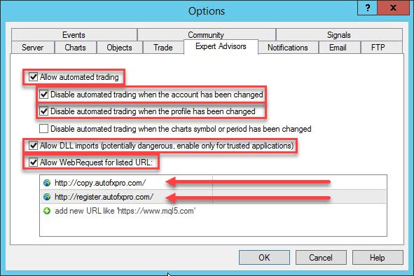

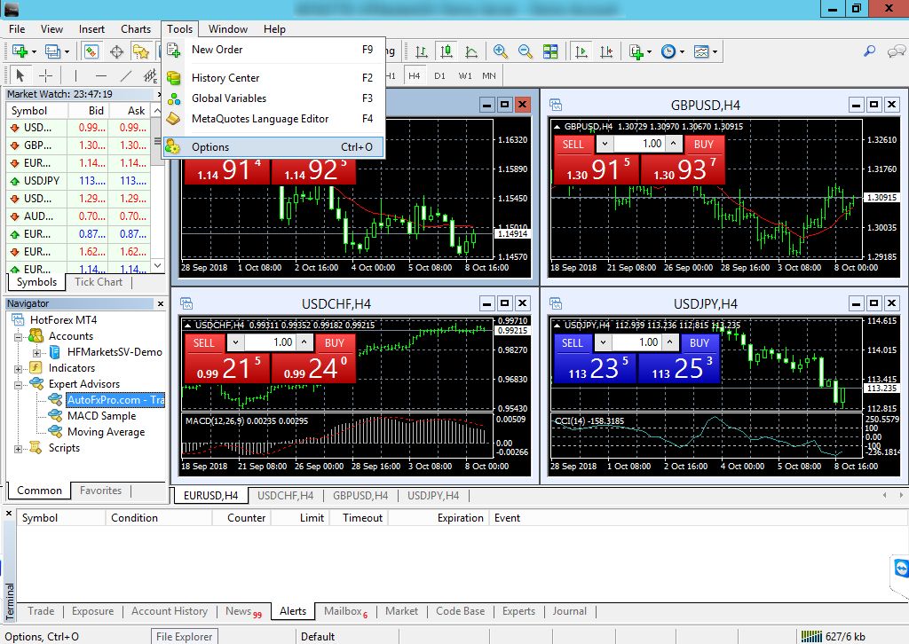

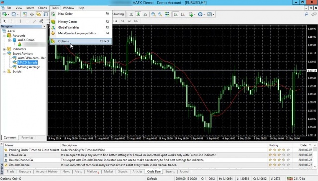

Before adding the copier to the chart you must set some options first. Go to TOOLS/OPTIONS and then change these settings.
You will need to add the following URLs to the list.
  • http://copy.autofxpro.com/
  • http://register.autofxpro.com/

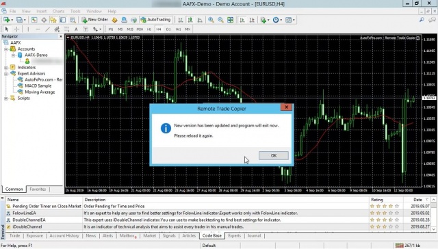

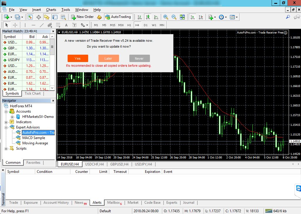

At this point you may drag the copier onto the chart – where you may be prompted to update. If it does, allow the update by clicking YES. Then simply drag the copier back to the chart once it’s done.
Once this is completed and you drag the copier back on the chart, it should look like the screen below. If not – maximize (make bigger) the chart you’re on.

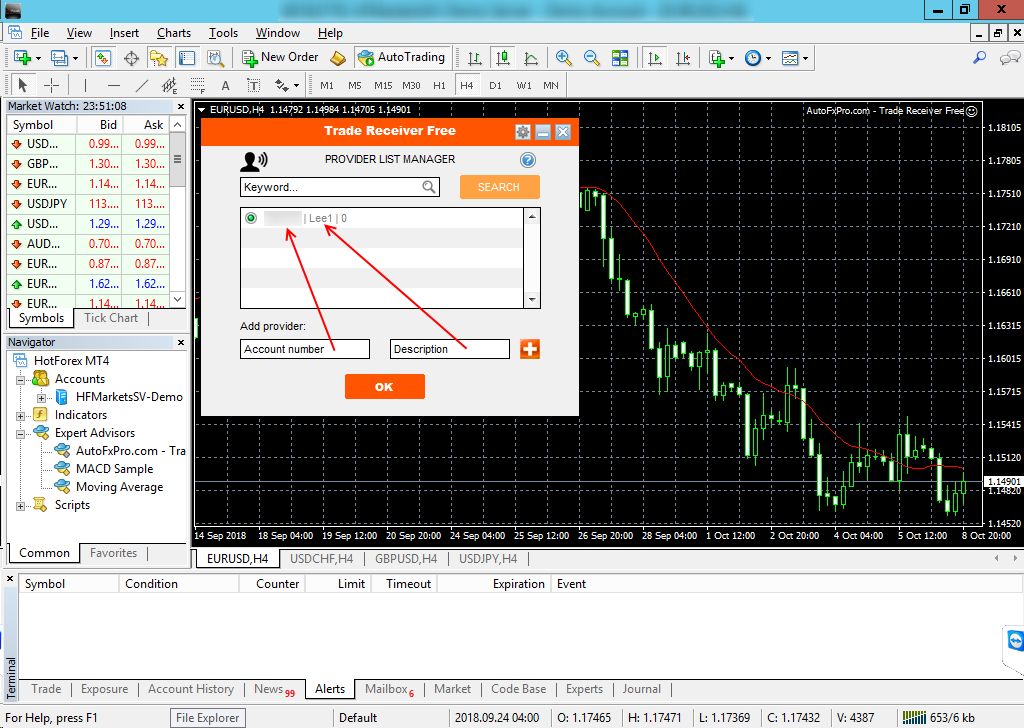

Adding Provider (The Person You're Copying From)

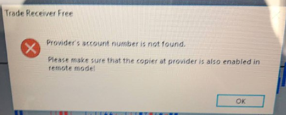

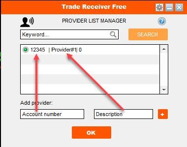

From here you click on PROVIDER LIST and add the numbers you received in the email. Add the number under ACCOUNT NUMBER and under DESCRIPTION you can add whatever you like – “Uncle Lee” for example.
If you receive an error like the one below contact an admin in the group. This means that your account is not enabled on both sources as yet – you should wait for a confirmation email or message from an admin. If you received this confirmation but still get the error below then definitely contact an admin.
Once this is done – set your risk management and then leave it to copy. The copier allows you to set various options and the PDF manual you received should go into enough detail on how to set this up.

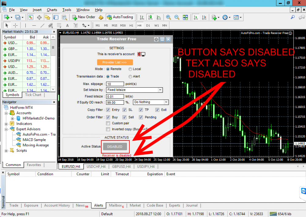

Enabling The Copier
These last pictures show where to click to enable the copier AFTER adding the two provider numbers. center

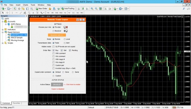

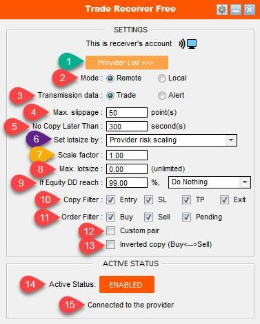

SETTINGS
There are 15 main settings with various sub-settings. A 16th setting will be covered at the end.
1 - The Provider List
2 - Mode

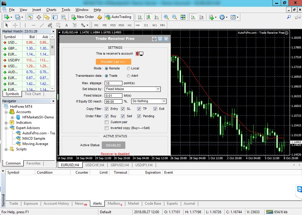

This changes between remote and local. If you’ve purchased the provider software and are running it on the same PC/laptop/VPS then you can switch to LOCAL mode.
3 – Transmission Data
This will either trade the account or just give you pop-up alerts of trades taken by your provider.
4 – Slippage
Slippage determines how far away from price a position will open/close. This is based on the lowest value available for the chart you are on. If your chart is in PIPS then it will be different from POINTS or PIPETTES. The default should be OK but modify as you wish. The image below shows what it would look like on a chart. You may zoom in for more details.
RTENOTITLE
RTENOTITLE
Again, this is not a comprehensive document, but intended to give a visual of what you should be looking for. If you need more details please consult the original manual. Some items are there that I may not fully understand the terminologies or what is meant by the person that originally wrote the program. Use or modification of the settings are done at your own risk – this is why each person has to change the settings to suit their needs.

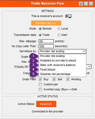

6 – Set Lot Size By
This section has 5 sub-sections.

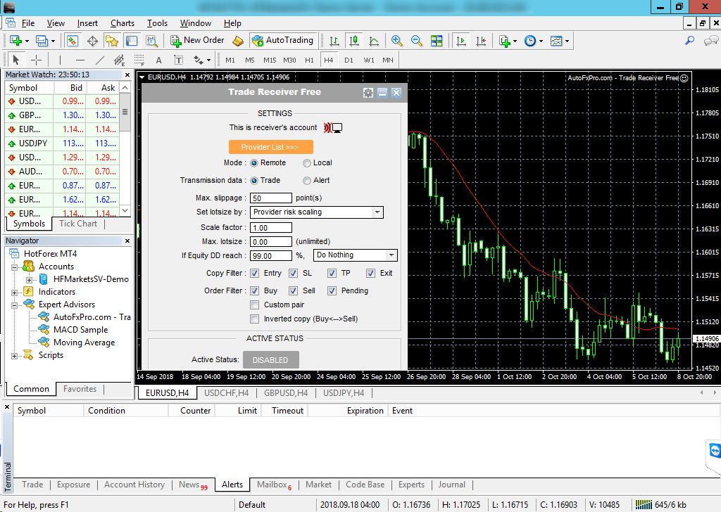

6.1 – Provider Risk Scaling
This opens trades based on the provider’s account size and lot size of their position versus your account size. This means if your account is $500 and the provider is $1,000 your lots will be opened at half of what the provider uses. Bear in mind that there is no position smaller than 0.01 and as a result trades taken at this size will be copied directly.
6.2 – Multiplied By Provider’s Lot Size
You can manually multiply the lot size that the provider uses to match your preference.
6.3 – Ratio With Receiver’s  Balance
This will open the lots based on settings you place for the balance/equity you have available.
6.4 – Fixed Lot Size
This will open a fixed lot regardless of what lot size the provider uses.
6.5 – Stop Loss Risk Percentage
This will specify your risk for each trade if a stop-loss occurs.
7 – Risk Setting
This option changes based on the options you select. Examples (from an older version) can be seen below. You may click each image for a larger view.

14 – Enable / Disable Button
This enables or disables the copier.

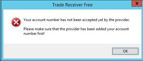

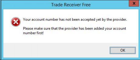

Account Not Accepted
If you have waited 24-48 hours and are still getting this message contact an admin.

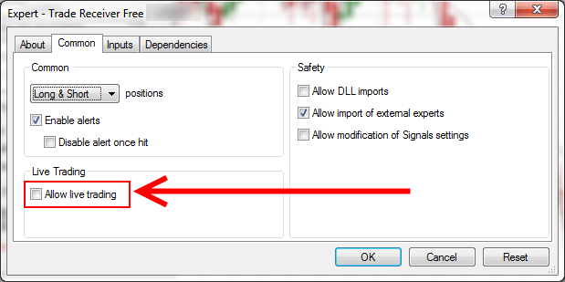

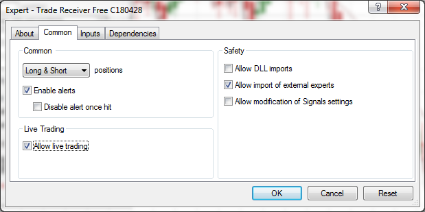

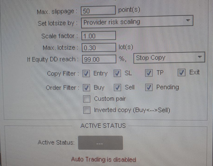

Auto Trading Is Disabled

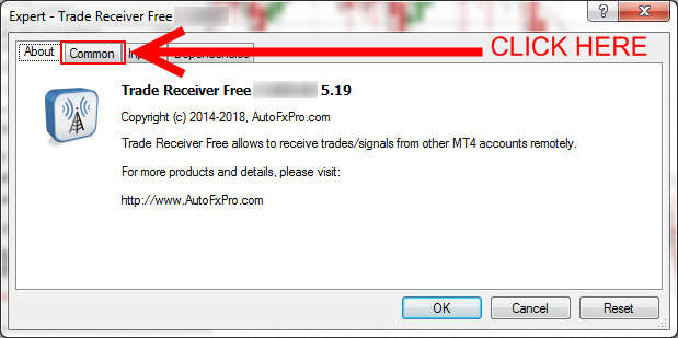

If you are getting this message then you probably did not follow the instructions on page 11 of this document. Please review and then press F7 on your keyboard which will bring up the properties for the copier. Click on COMMON and then ALLOW LIVE TRADING. Please see photos of that below. Ensure it is checked.
The final product should look like the one below. Once done, click on OK and proceed with the setup.

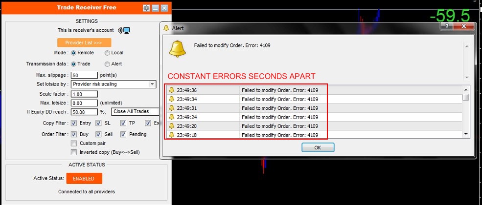

Constant Error Notification
If you notice this error please place the copier on a new chart with no indicators. It may be required to have another MT4 specifically for the copier as other indicators may conflict with the copier.
Copier Not Working
Double check your settings with pages 10-12 of the setup document. Ensure the following URLs are in MT4:
Also verify that the MT4 number you gave is correct. The number is usually copied and pasted into the program, so if there is a missing or incorrect digit there may have been a typo at submission. Contact a member of the admin team if you suspect your number is incorrect.
Copier Not Updating
This is similar to the error above. Ensure that you have HTTP and not HTTPS as well as check back the settings above.

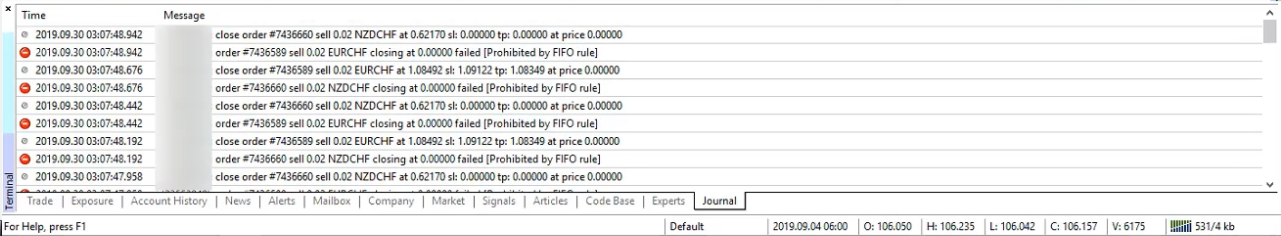

Broker (FIFO) Issue
The first thing to do is verify whether or not your broker is a US regulated (FIFO ). Please see the link below for more details.
https://www.babypips.com/news/faq_fifo_in_the_forex_market
From what we’ve seen, multiple positions of the same size on the same pair need to have the same TP. For this issue you would have to change the broker. If you don’t want to change the broker then the fluctuations will continue.
A workaround would be to disable the copying of the SL and TP. The trades should still close on your account once they are closed on the provider side. This will also allow you to set your own SL/TP.
RTENOTITLE RTENOTITLE
If this does not work for you - then you may have to change the broker. Check your journal for any messages similar to the one pictured below.

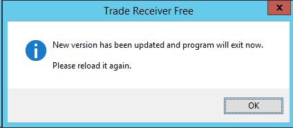

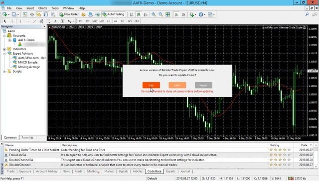

Cannot Update
RTENOTITLE
If you can't update the copier there are two options.
  1. Download the latest version from the autofxpro.com website.
  2. Download the older version from Google Drive and then allow it to update when started.
Both options have been tested and proven to work. Pick whichever is more convenient. You may have the old version in your DOWNLOADS folder. You could try option 2 first if this is so.

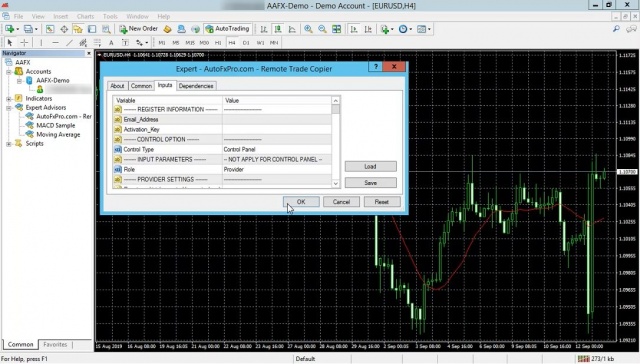

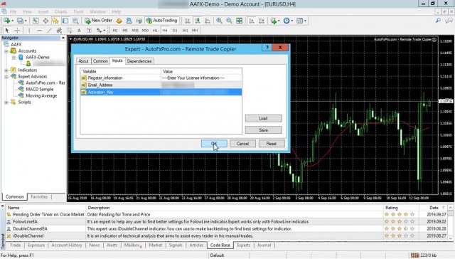

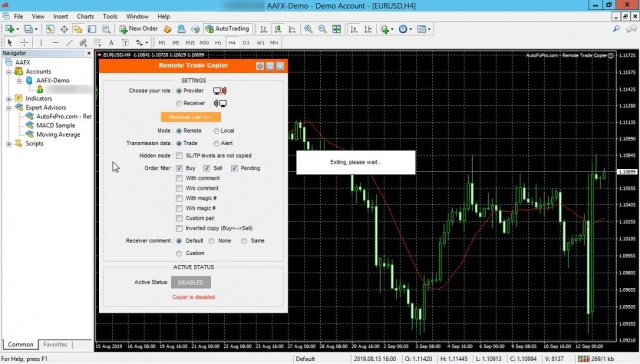

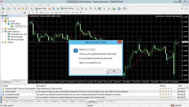

Once you're done - double click on the AutoFxPro EA from the list in the navigator window. You may also drag it onto the chart. Switch to the INPUTS tab and put in your email address and license key.
If your details are correct, the copier will be registered and you can proceed. If the copier was not up to date then you'll be prompted to update thereafter.
If the program shows EXITING, PLEASE WAIT - just wait until the chart is clear.
Once it's done - double click on it again (or drag it onto the chart). You do not need to put back your registration details if it was successfully registered initially. The details are saved and the values are blank so that persons won't be able to see and steal your key for usage.

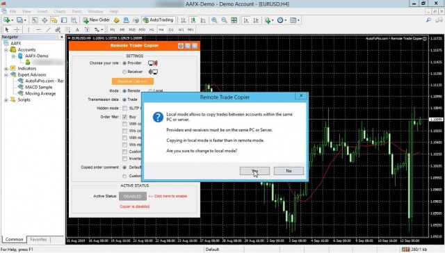

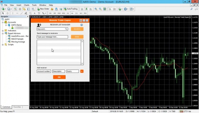

Adding Receivers / Local Copies
The copier may be used in remote or local mode. In remote mode you must add the MT4 account number for each receiver. In local mode you only need the provider number to be placed in each client.
Remote Provider
If you're going to be sending signals over the internet, then ensure that you have the account numbers for the persons that will be copying. If your service is a paid service then check your subscription list and you can then enable/disable receivers as needed. Firstly, go to the RECEIVER LIST.
From this screen you can add the ACCOUNT NUMBER for each receiver along with a DESCRIPTION. Usually the subscriber name or email address is placed here to make them easier to be found. You may also set an EXPIRY which would automatically disable the account once the expiry date is reached.

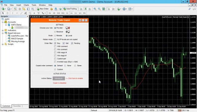

Local Copy
This mode is faster than remote and the prompt that appears when you switch the modes tells you just that.
Just like the receiver - you simply press the DISABLED button to enable the provider. Note that in LOCAL mode there is no subscriber list. All you need to do is put in the provider number in all of the receivers for trades to be copied.
